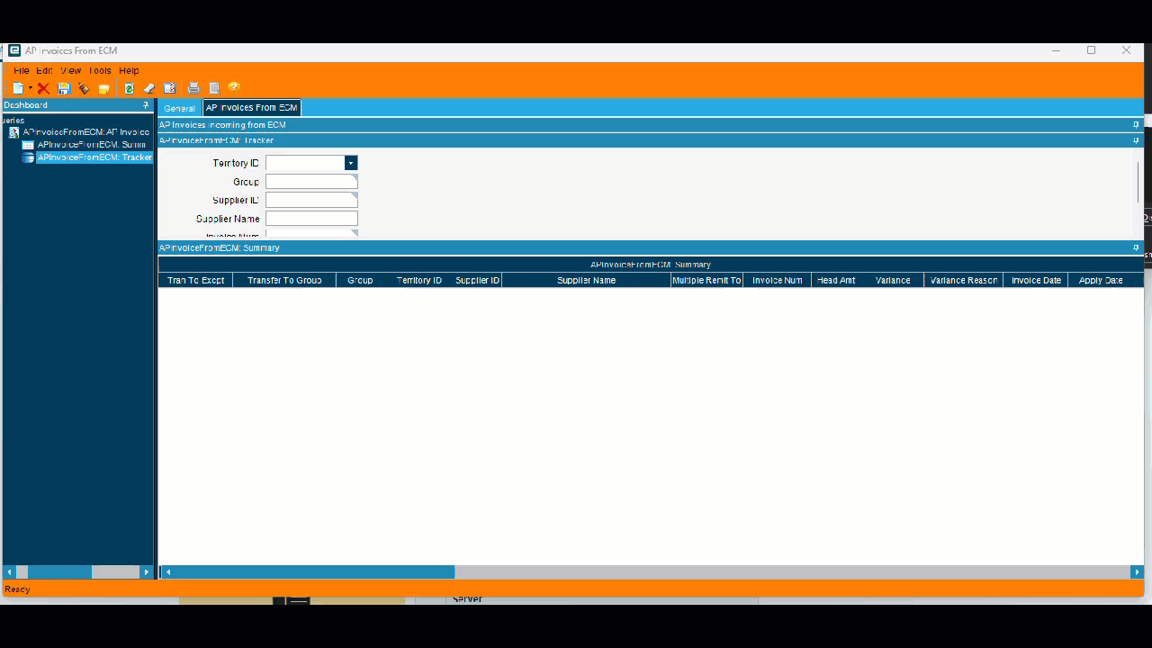

Dashboard tracker layout issues
Everything works correctly while running the dashboard. However, after deploying the dashboard and reopening it from the menu, the tracker changes (such as the tracker conditions/settings) are automatically reverting to their previous state. if I’m missing a deployment or configuration step?

There’s a “Bug” in run time dashboards where the dashboards don’t remember the size of the tracker. If you go to properties, click ok, then they will go back.
Tracker Properties
To save it, you need to deploy the dashboard, then on the menu choose “Assembly” dashboard, so it’ the compiled one, and not runtime.
