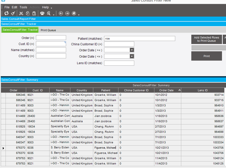

All, just moved to 10.1.500.17 from 10.0.700.4, when typing a string into a tracker field that had a matches filter it would allow them to return results without the use of wild cards as shown below (almost acted like a contains)
now they must either enter an exact match or use wild cards… so the million dollar question is, which version is/was working correctly or ‘as designed’?
