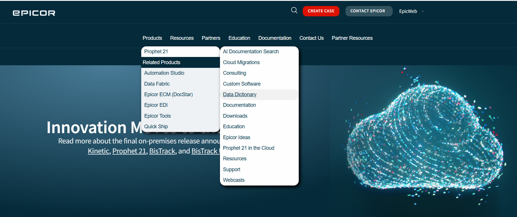

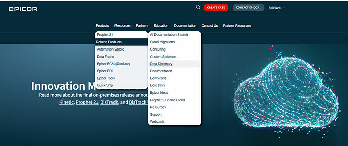

Hi
For Prophet 21 the data dictionary is found on the EpicWeb at https://epicweb.epicor.com/
Good Question. Not sure where the data dictionary for P21 is. In Kinetic there is a menu item for it. Is there anything in the help?
Thanks for all the help. It appears for P21 SaaS that ICE is managed by Epicor, at least - I can’t seem to find it. Nothing in P21 menu navigation or knowledgebase about data dictionary. I think Judson has me on the right track. Since I’m brand new here, I don’t have access to EpicWeb but I have a request in for access. I appreciate all the responses and help.
