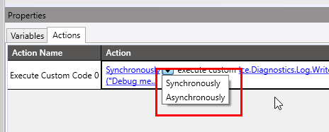

In a In-tran DD, the Execute Custom Code widget has two choices:

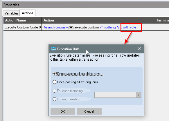

in a Standard DD, there is also a "with rule" setting, which provides the following pop-up
That pop-up is the same, regardless of sync or async selection.

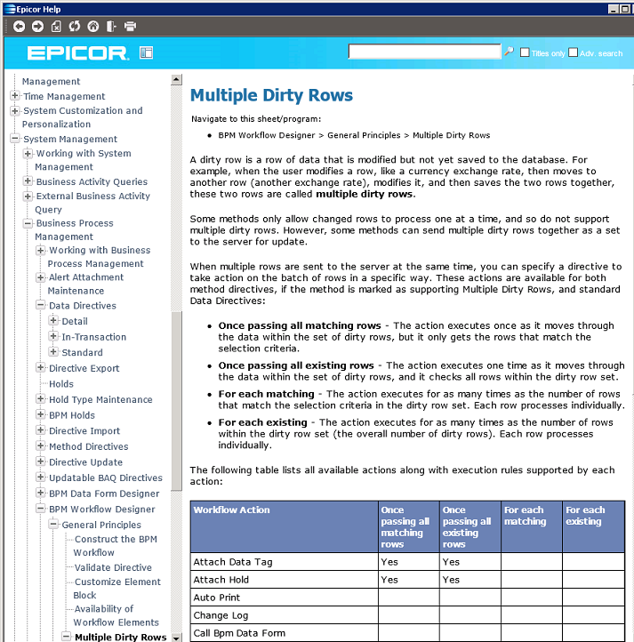

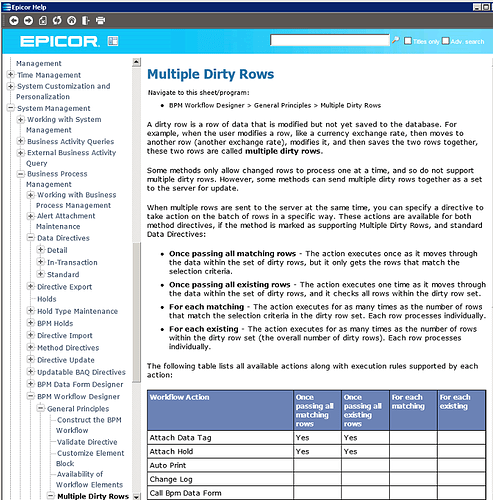

There is a section in the embedded help that (I think) explains what is going on there.
Ref screen shot…
And now that I’m looking, this I wonder if this option might help resolve a change request to the way some old BPM’s are sending emails. TBD…
Multiple Dirty Rows (BPM Workflow Designer > General Principles > Multiple Dirty Rows)
SOME methods can send multiple dirty rows together as a set to the server for update
