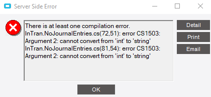

Let’s say we want to prevent a journal entries on account 1150-00, I pull in the condition and use "Specified field has been changed from “any” to “1150-00”. I can validate and it says nothing is wrong, but when I save in the Data Directives menu I receive this error
I have limited experience with Data Directives, so I appreciate any help!

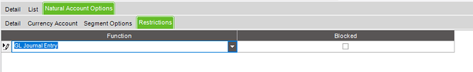

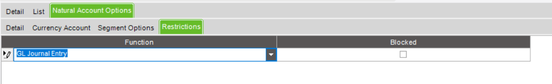

OK, I think I found it. In Account Segment Values Maintenance, there’s a Restrictions Tab and I think you can block it there:
Awesome!
I’ll check it out tomorrow and see if this works for us.
This is perfect, much appreciated!
