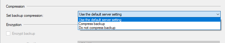

I “use the default server settings”. You know how to figure out the default backup compression settings?
It didn’t go anywhere. You have to remember that the raw database is filled with thousands of empty columns. When the backup gets compressed it ignores all that “whitespace” and you end up with what is more a true size of your database. Our MDF is about 48GB our backup is about 2.25GB it’s pretty standard
