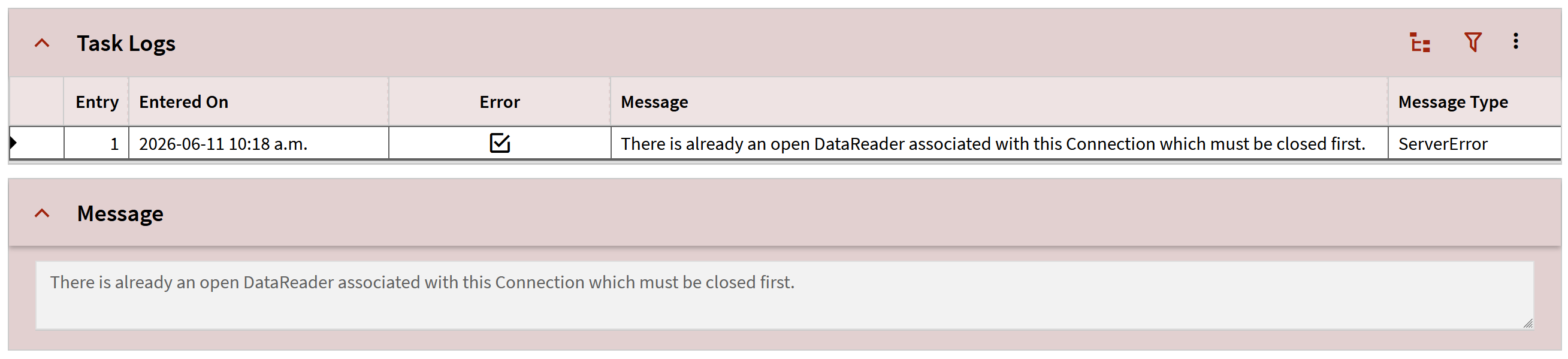

DataReader error in 2026.100
We are seeing the below error in a few places while testing 2026.100, has anyone else seen this or know what to do about it?
This came up in Sales Order Entry, correlation ID brought us to a BPM that we’re looking into.
This also came up when i did an AP Payment. Process Payments - Select Report Style - Print. My payments worked, the payment number and sequencing inside AP Payment Entry worked but the report (remiitance advice) did not work.
