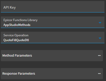

I am trying to add two columns in the quote line table showing unit setup cost and unit prod cost for each quoteDtl line.
As such I made a function taking and returning a dataset in parameter :

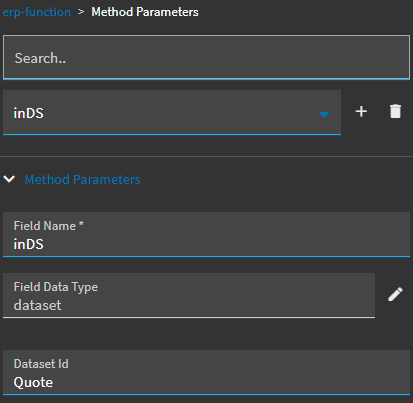

In application studio i set an event on GetById to send the full dataset to the function, and uses it result :
But when i try the quoteDlt part of the dataset is empty, so nothing happens. How do I get the full dataset ?

You need to add the quote adapter to your Function and then you can specify the actual quote tableset as your parameter.

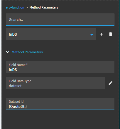

If all you want is QuoteDtl why not just send only QuoteDtl?

If I do so I get this error :
I guess this is because Quote is the dataset, and QuoteDtl is a dataview in the application referencing a table of the dataset Quote.
I just don’t get why there are rows missing from it.

This makes no difference. I send dataviews to functions all the time with the syntax shown.

I completely forgot the power of curly braces as it actualy sent data without them ! Glory to the braces !

Gabriel:
Curly braces to send the dataview.
No curly braces to send the dataset.
You know. To make everything confusing for the users. LOL
