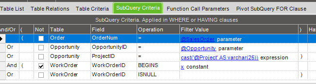

And I don’t want it there. But the Epicor code put it in there, when I used the Table Criteria on the dbo.Order:
I just want it in the Where Clause.
When I rearrange things in SSMS, it works perfectly. That’s what I was trying to say before.
I don’t understand why the BAQ puts the table criteria as a Join condition.
Try removing it from the Order table criteria and adding it as Sub-query criteria

This is the working code:
cast(‘@Project’ AS varchar(25))
Needed some apostrophes.
All working!
Thanks again!

It kept calling “Bad SQL Statement”.
I had to go to the server log to get the code:
"Error:System.Data.SqlClient.SqlException (0x80131904): "
Need to declare @Project.
The single quotes did the trick…
