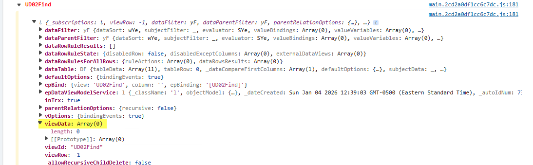

I have this and it evaluates to false as it should. I took out Key3 and it got results in the temp dataview of multiple records as it should.

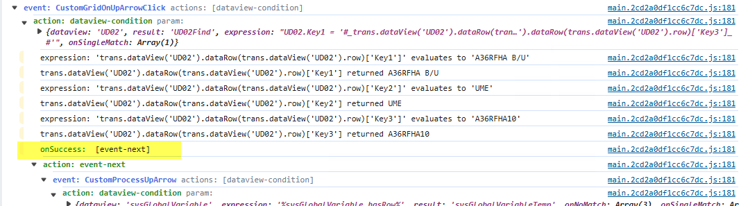

UD02.Key1 = ‘#trans.dataView(‘UD02’).dataRow(trans.dataView(‘UD02’).row)[‘Key1’]#’ AND UD02.Key2 = ‘#trans.dataView(‘UD02’).dataRow(trans.dataView(‘UD02’).row)[‘Key2’]#’ AND UD02.Key3 = ‘#trans.dataView(‘UD02’).dataRow(trans.dataView(‘UD02’).row)[‘Key3’]#’

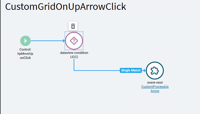

Here is the event.
Thing is, the dataview-condition widget acts as though it were successful and continues processing. It should not process at the point of testing where I’m initiating this event.
There is no data in the temp dataview for any found rows, so why is it firing the event as if there was a single match?
