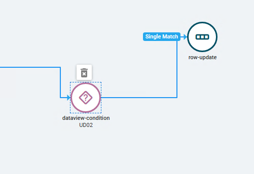

I have a dataview-condition with the following expression
I have saved the guid of the row I need to update in a previous step and the value is there in the sysGlobalVariable dataview. Funny thing is, this was working yesterday, but because I deleted and re-added widgets/arrows on my event, the subsequent widgets didn’t fire anymore and I had to recreate most of the event. Now this one condition isn’t working.

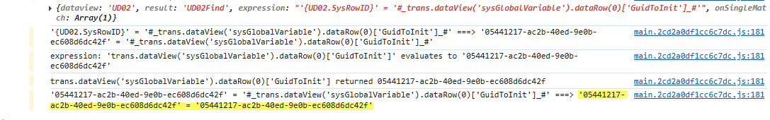

Here is the debug from two different ways of doing it. The first way seems to be the right syntax because I get no errors.
'{UD02.SysRowID}' = '#_trans.dataView('sysGlobalVariable').dataRow(0)['GuidToInit']_#'
I used this expression for this result.
‘{UD02.SysRowID}’ === ‘{sysGlobalVariable.GuidToInit}’
I’ve tried various different ways with the syntax. It doesn’t like double quotes but needs to be encased in single because of the format of the guid itself.
