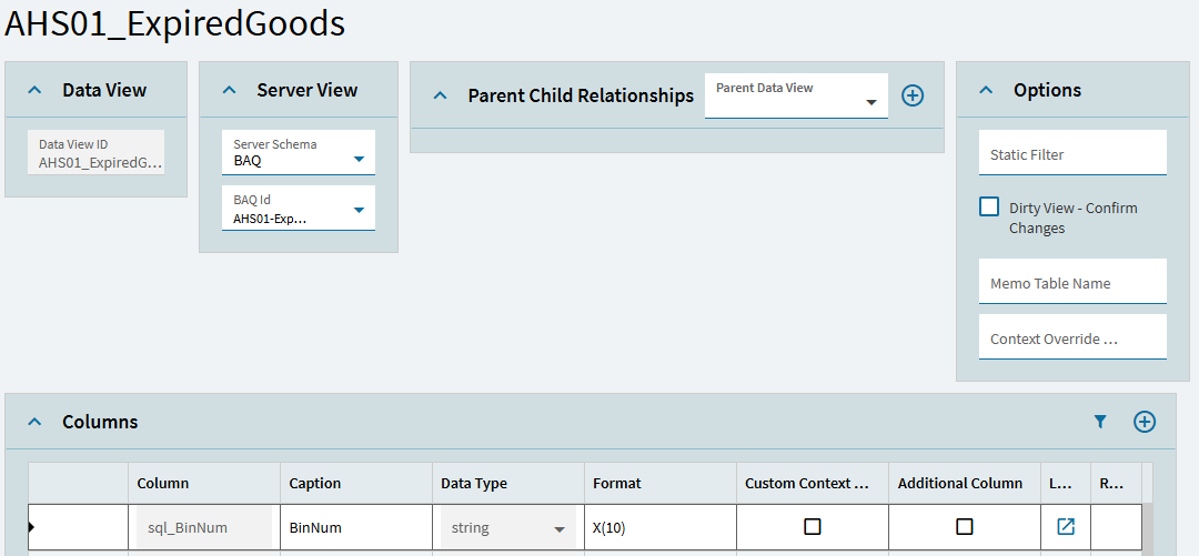

I’m setup without filters here:
And no filters on the dataview:
Only other place I can think of where a filter might be applied is something in the grid, but it was setup using guided setup, and there’s basically nothing in it, except the epBinding to my dataview, and the columns are built out.

It wasn’t an issue with the function or its output - I’d already confirmed all the data is coming down to the client from the server. So I tried the other end first.
I removed the reference to the BAQ in the dataview definition, added each column manually (not 100% sure this was necessary), published and ran it - and everything is appearing like it should.
