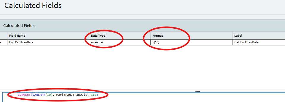

For whichever date field you want to modify you need to create a calculated field.
Change Data Type:
Format: x(10)
Expression: CONVERT(VARCHAR(10), table.field, 110)
For this example I used PartTran.TranDate, so the expression would be CONVERT(VARCHAR(10), PartTran.TranDate, 110)
Now you can see if comparing to the actual TranDate column that our calculated field is hyphen separated if we test the query.
Screenshot 2025-10-10 120957
When you export the query to excel even though the normal TranDate showed as a short date code it has the time stamp, but the new calculated field does not.
Hope this helps.
