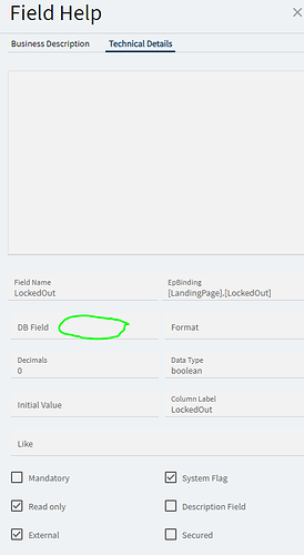

Hi Experts,
I am looking for the data field where the info is stored if is user is lockedout (due to 3 times not entering the right password)…
the tech info db field is empty
Can someone help me?
Thank you, Lars

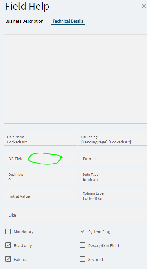

Hi Experts,
Thank you, Lars
It’s in a different table.
Hi Mark,
ok, it is in another table, but oi which one?
Sorry, maybe I do not understand your answer…
br, Lars

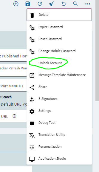

The link explains that there is no field but the existence of a record in the UserLoginStatus table.
When looking for information like this, it is quite useful to run a trace to see what’s happening. In User Account Maintenance, there is no way to uncheck the lockout box. One must click on the Actions menu. Following the trace, you will see the relationship with UserLoginTable.
