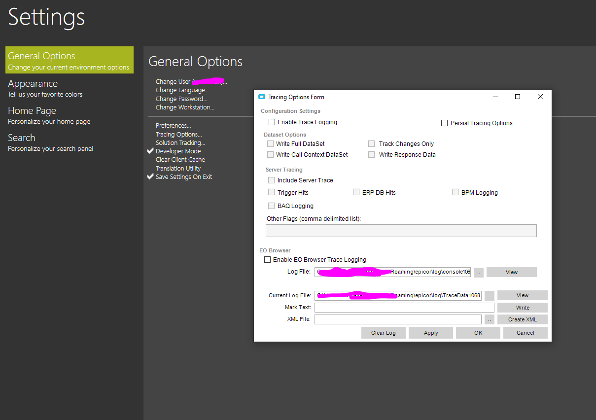

Maybe you are in need of using Tracing by any chance?
This is where you can activate it on your account (admins can activate it for other users through user account security maintenance):
The log file then can be examined when you stop tracing.
You can use this also to see what BOs get used when a menu is getting loaded and in general tracing application itself as well.
