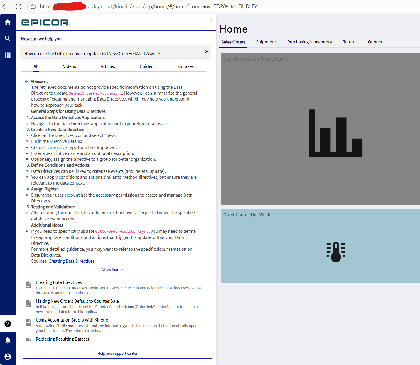

Post a question. It should just be a one update on the row after its been called. If you have used the BAQ designer or data directive maint your not a million miles off.
If your on prem or 2025.2 you can ask Kinetic:
