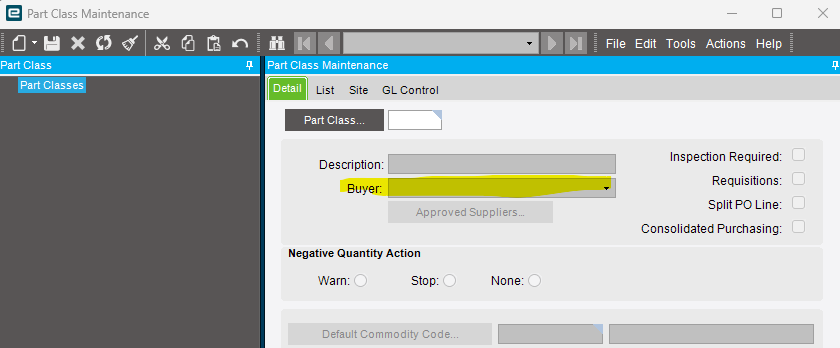

I will elaborate a bit more on what I replied with. If you set all part class master records with your default buyer (see below)
then set each part number buyer with your real person buyer unless you want a part to go to the default buyer then leave the buyer blank for this part and it should default from the parts part class buyer (ie default buyer).

We set buyers at the Part Class too with only exceptions at certain parts. Much easier to change buyers.
