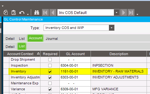

Within a Type GLC will be several contexts. For example, the “Inventory COS and WIP” there are contexts like what is shown below:
The highlighted line shows the GL account to use for the Inventory context of the “Inventory COS and WIP” type. What is not shown is that this is just one of several settings for the “Inventory COS and WIP” type. This one happens to be named “Inv COS Default” (a name I chose).
Now I have a defined GLC. It has the following properties:
- Type: “Inventory COS and WIP”
- Name: “Inv COS Default”
- Contexts:
- Drop Shipment: No account set
- Inspection: 6304-00-01
- Inventory: 1151-00-01
- and more (including WIP, COS, etc…)…
