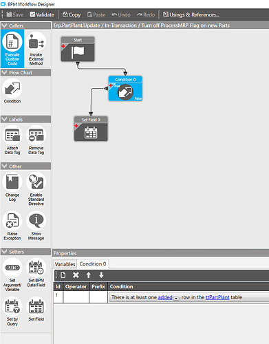

I am trying to default the processMRP flag to false on the creation of a new part. All of my attempts to do this have failed. Any help/ideas would be greatly appreciated.

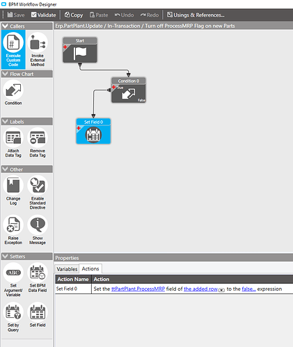

Have you tried a Data Directive on Erp.PartPlant, with a condition set to look for Added Records and Set Field ProcessMRP = false.
No, would this be an in-transaction? And how would I set up the condition?
I can confirm this works, had it running on my system for a while.
It’s In-trans directive.
