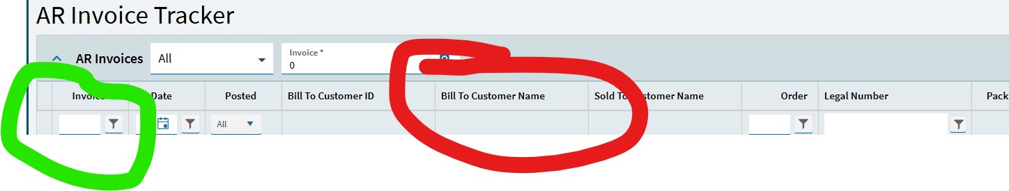

How do I keep the default sort by Sold To Customer Name in AR Invoice Entry in Kinetic? It doesn’t respond when ‘save layout’ is selected.
The issue we have with this is that because you can’t search/sort a text field (Sold to Customer) without downloading all of the records first, it doesn’t/won’t save. You will notice that you can save a sort if it’s a numerical field (etc.) such as “invoice” that is searchable on the initial load…
