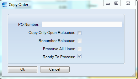

I would like to default the ready to process flag as “yes” (screen snip below)
Can this be achieved? If so please let me know how.

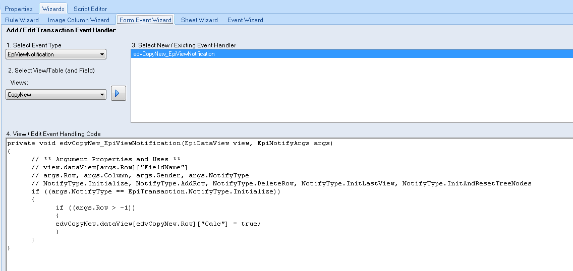

This can be accomplished by using a customization. You can use the form event wizard (one way) and just add something like this.

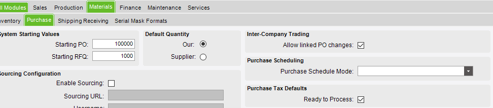

there is also a company setting under Company Config - Materials- Purchase. That should do the trick
Anya
What flag under this setting defaults the ready to process flag during the Sales Order copy process? I am always curious to learn a setting I am not aware of.

I think she is referring to this Ready to Process flag.

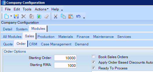

I am pretty sure that does not change the Ready to Process flag on Copy Order or the resulting copy.
There is a flag for Sales Orders and Different Flag under Material - Purchase
Gotcha - I was definitely aware of the Sales Order flag, which does not help Copy Order but was curious about that other flag. That is an E10 only flag though, correct?
I found this and it’s already ticked “ready to process”
Yep. That will not work for copy order. Check out Epicor support article 15626MPS. There is another way listed there on how to work around this.

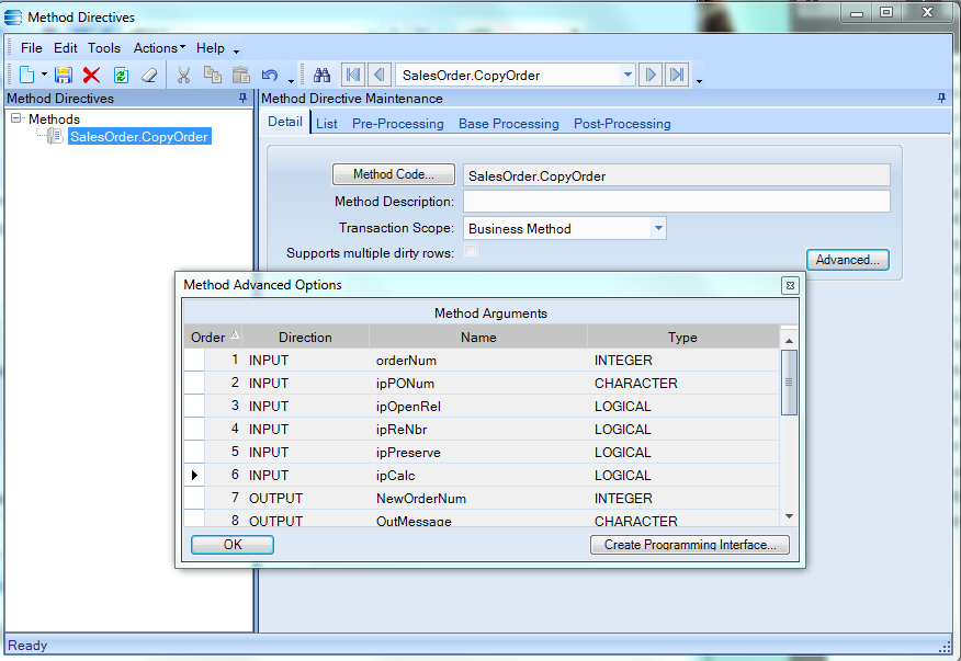

I have read others have defaulted flags, but I am super unfamiliar with baq’s and bpm’s… I feel I’m on the right track? If this is do able on a bpm?
I’m almost 90% sure its line 6, but after that I am unsure of what to do.
I think it has to do with line 6 because I’ve read the ready to process flag has to do with calculating taxes.
You can create a pre-processing directive and then with an action set ipCalc = true or set it to the value of the order it is copied from. This is simple but does not flag the field in the Copy Order screen as Ready to Process but does flag the resulting Order correctly. The support article I mentioned has this code in it.
