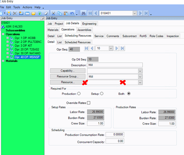

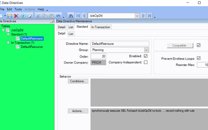

I’m looking to default the JobOpDtl.ResourceID field to “unassigned” every time an operation is added, the only condition i need is only do this when the field is blank.
Here is some ABL i have written but it doesn’t seem to work:
For each ttJobOpDtl no-lock.
If ttJobOpDtl.ResourceID = ? Then Do:
/* Set the ResourceID field of the added row to the “unassigned” expression */
Assign ttJobOpDtl.ResourceID = “Unassigned”.
End.
End.
I have applied this ABL to a Data Directive using the JobOpDtl table in the Standard tab.

On the Data Directive, my understand is this:
Standard Fires after the row is committed to DB. Used for email alert, logging etc. Too late to make any changes to tt Table
In-Trans Fires before the row is committed to DB. Use this one to make changes to the tt

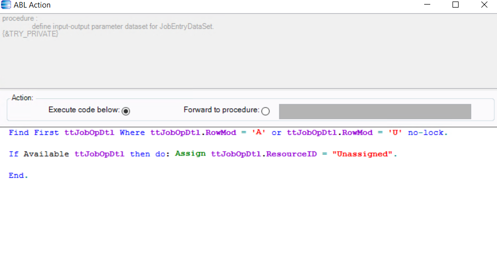

What I would do instead is create a Method Directive under JobEntry.Update that has a criteria stating that ""There is at least one added row in the ttJobOpDtlTable. Then try utilizing the following code:
Find First ttJobOpDtl Where ttJobOpDtl.RowMod = ‘A’ or ttJobOpDtl.RowMod = ‘U’ no-lock.
If Available ttJobOpDtl then do: Assign ttJobOpDtl.ResourceID = “Unassigned”.

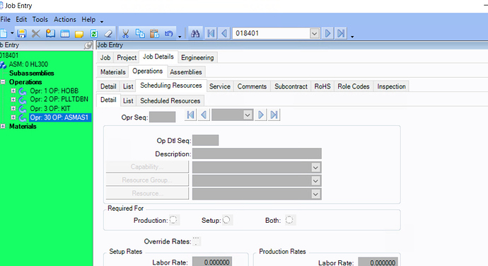

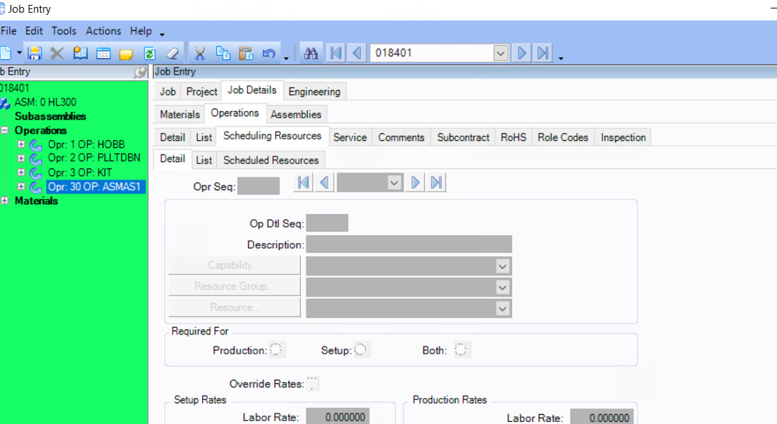

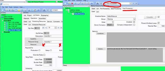

Hi Kevin,
I tried this as per screenshots - but still no joy.
I wasn’t 100% sure on how to write the condition, so i thought well if i can get something going for no conditions that would be a good start, but nothing.
Sorry about that, I should have clarified that it should be in the Pre-Processing! As far as I’m aware, you can only update the temporary tables in the Pre and Base processing. (I also stray away from using Base-Processing as this is when the Epicor process is active for the function and it’s better to perform user functions before or after it)
Changing it to Pre-processing didn’t really work, when i added an op its just greyed the fields out and left them blank.

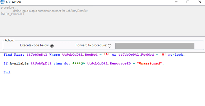

Alright, got it figured out! Head back to what you were doing originally in Data Directives, but utilize the In-Transaction instead of Standard. And then try out the following code again with the condition set to “There is at least one added row in the ttJobOpDtl table”.
End.

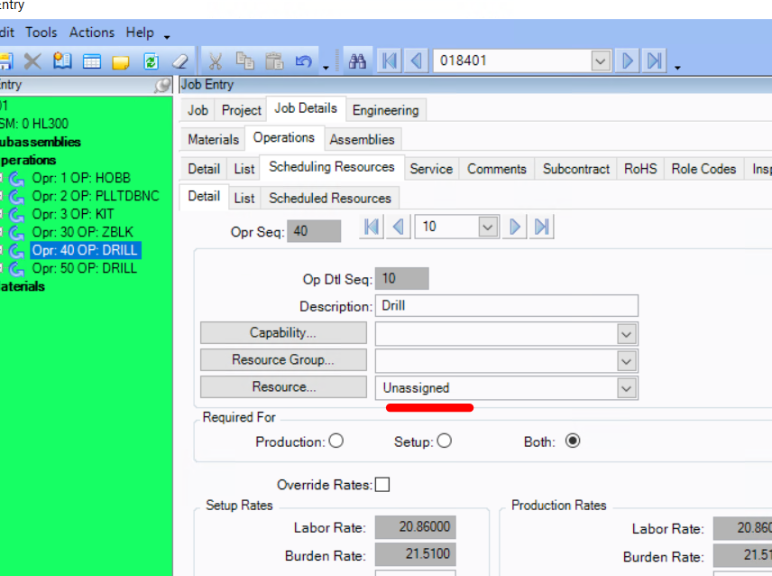

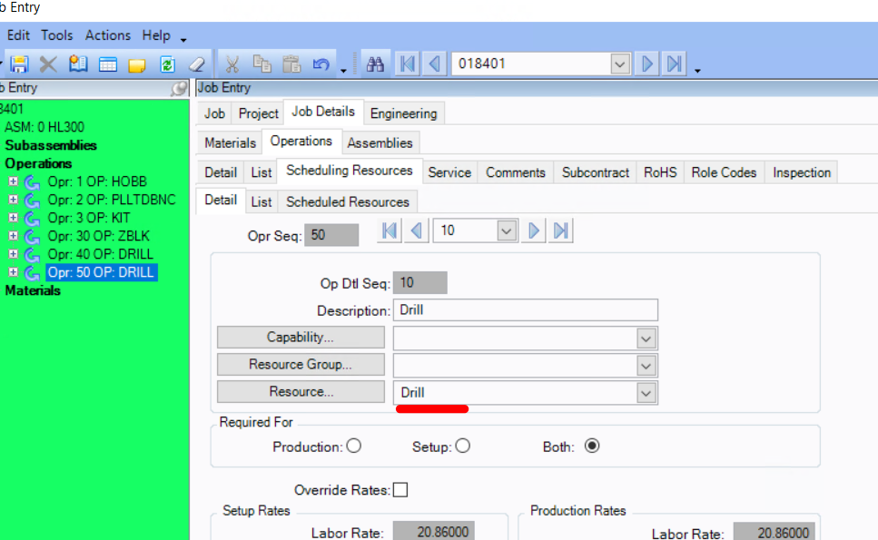

so this is when the BPM isn’t enabled:
and this is when it is enabled:
So, its certainly getting closer, it just requires a further condition either in the ABL or directly in the BPM to only apply it when the field is null/blank.
