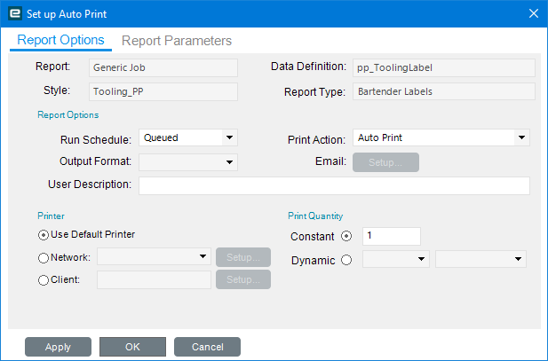

I’m hoping someone can shed some light on how this works for me because I’ve confused myself and feel a tad lost. Long story short I have a data directive that’s set up to fire off an Auto Print job on one of my user defined tables, however I can’t seem to figure out how to define or change what the Report Parameters are for my job. The only thing that changes these parameters is if I select a different existing report, but within Kinetic I can’t seem to locate where these exist.

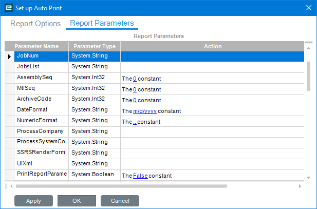

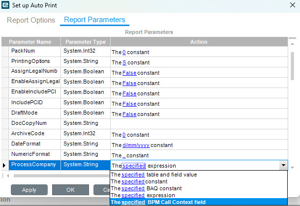

Change teh witdht of the dialog box and you will see that the actions are actually drop down list boxes,
I think that if you select one of those options to get the information you need.
You may need to pass in the job number as a bpm data field from the intrans directive.
