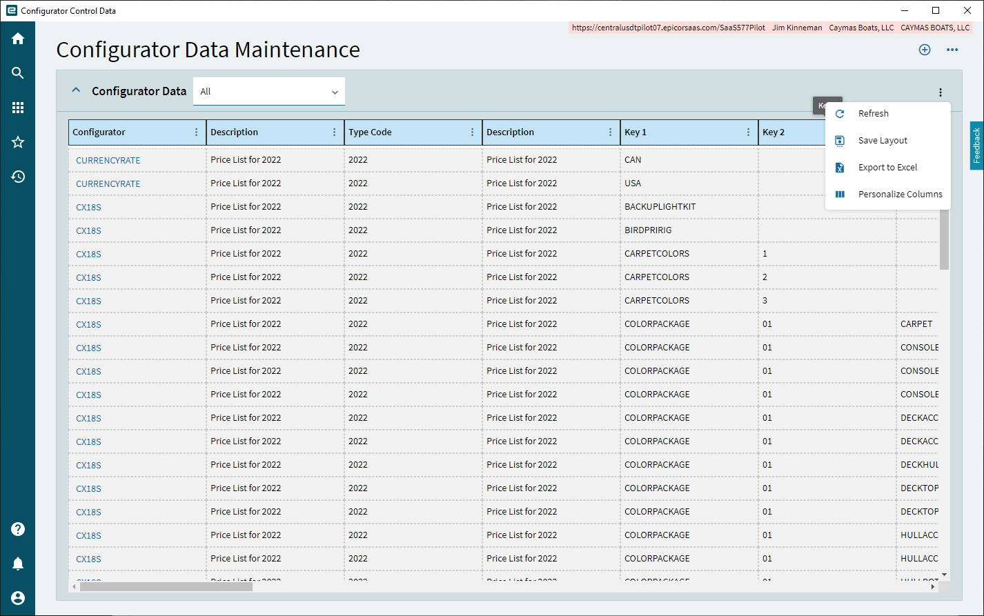

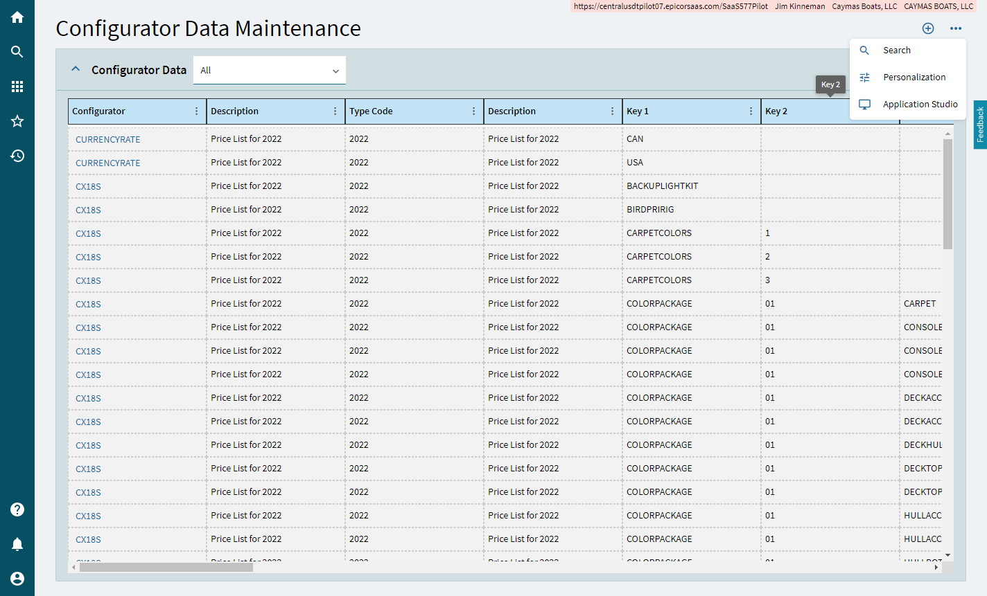

Might be staring me in the face but I can’t find a way to delete a row in a grid in Kinetics. Working with the PcConData table list grid and I want to delete several rows. Understand if it is still one row at a time. There is the plus sign for adding a record but nothing for delete.
Configurator Data Maintenance appears to be missing the ability to delete a row. Not a big deal as I can go back to the classic version.

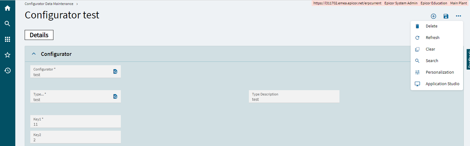

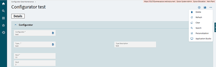

The landing page by default does not allow you to delete entries you can when you drill in.
We can take feedback on that though as Tim said.I’ll leave feedback, that is a nice feature.
Having to drill into a record to delete it will be tedious.
