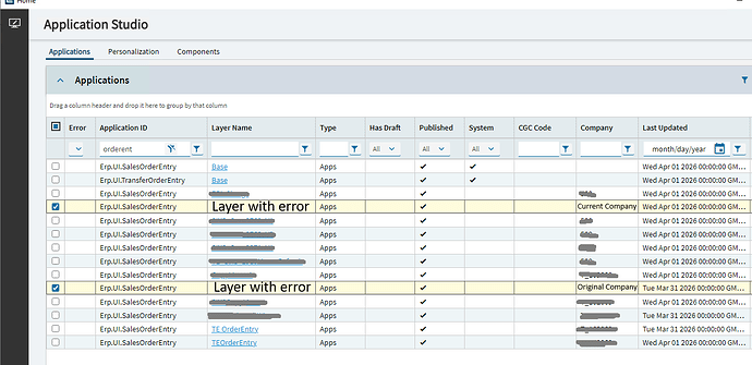

Hello! I imported a layer from LIVE to PILOT with the idea of overriding the one in PILOT to undo the changes, but instead it created a second layer with the same name.
Now I’m not able to edit or delete any of those layers.
In the application studio grid, each time I select one of those layers, the second one is selected as well.
If I click on delete selected layers, nothing happens. Checking the network traffic, I see the BulkDelete method returns “Record not found.”

I was able to delete the duplicated layer. It did select both but only deleted the one I added. Then reimported the layer and checked the company toggle and that actually overwrote the one I was trying to overwrite.
I’ve had it do this but was able to delete the layers and reimport.

In my case one went to my company ID and the other somehow to T_{my company id}
