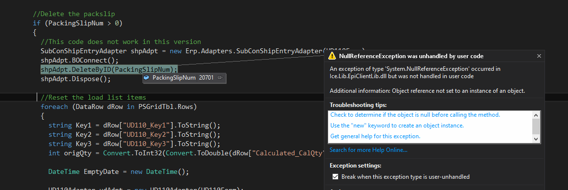

Has anyone found a way to delete a PackNum record in the SubShipH table from a c# customization?
The only way we could do it was to Launch the Subcontractor Shipment Entry form and manually delete it.
We tried this code and got the exception in the image below.
    if (PackingSlipNum > 0)
        SubConShipEntryAdapter shpAdpt = new Erp.Adapters.SubConShipEntryAdapter(UD110Form);
	    shpAdpt.BOConnect();
        shpAdpt.DeleteByID(PackingSlipNum);
        shpAdpt.Dispose();
