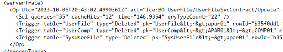

@Chris_Conn It looks like you can only change the plant list in UserComp or if you want to delete you have to go up to UserFile and delete that record which also deletes UserComp
<paramDataSetChanges>
    <paramDataSet name="ds" useDataSetNbr="0">
      <deletedRow tableName="UserFile" rowState="Deleted" rowNum="0" />
      <deletedRow tableName="UserComp" rowState="Deleted" rowNum="0" />
    </paramDataSet>
  </paramDataSetChanges>
But when I tried to to a ubaq and see the code that it generated there are a bunch of issues, so I think this is a no fly zone.
