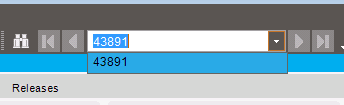

One more thing. Is the quote it jumps to loaded in the form? (this sample snippit shows just one record “loaded”)
