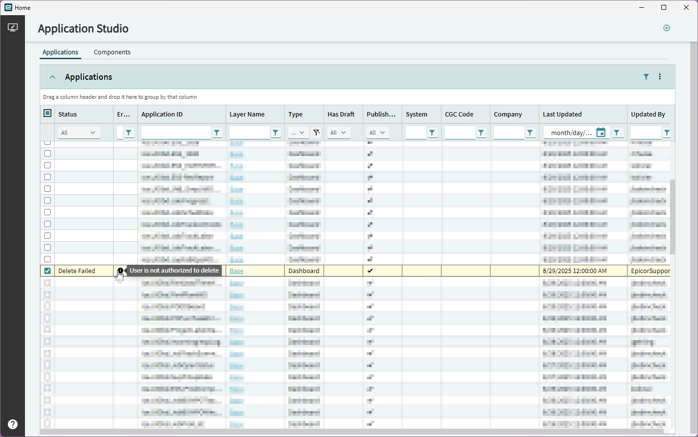

Is anyone else able to delete non-system dashboards in 2025.1.11? I try to but I get a delete failed message detailing I do not have privileges to delete (I’m a security manager). EpicCare is wanting to give us a data specific data fix for every dashboard deployment we want to get rid of.

I’m having the same issue as you trying to delete custom dashboards (base). We are on 2024.1.32 so I’m not sure whether this should work yet or only works in 2025.1??
I can delete custom apps (both base and layers) and I can delete custom dashboard layers, just not the base record. I get the “user is not authorized to delete” message despite being a security manager.

If the Dashboard was converted/deployed from a custom dashboard in Classic - I can successfully delete new layers created in Kinetic but cannot delete the Base created by conversion. I get the delete failed - user not authorized to delete error message.
