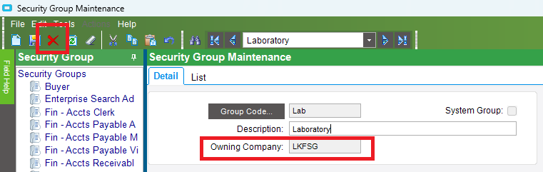

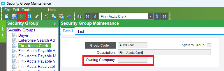

i am thinking of revamp the Security Group to a consistent naming convention.
However, I realized that some of the security group created sometimes ago are not able to delete.
Only visible difference is that the one that deletion is no enable are those without “Owning Company”
Wonder if there is any work around to delete it.
Below snap-shot show one where the “X” is red and able to delete while another is grey-off
This will require Epicare to provide the data-fix to delete the respective Security Group.
Service Desk will request to perform an SQL query on all the security group and the data-fix are targeted on the exact name of the security group for deletion.
You could try getting rid of them via Rest v1 (and can just use the swagger interface). I would try in a non prod environment first - but it may work.
