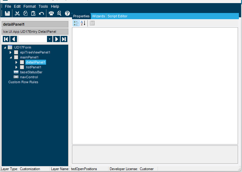

Was working on one customization and somehow it lost all details for the details tab:
So, apparently have to completely rebuild the customization…

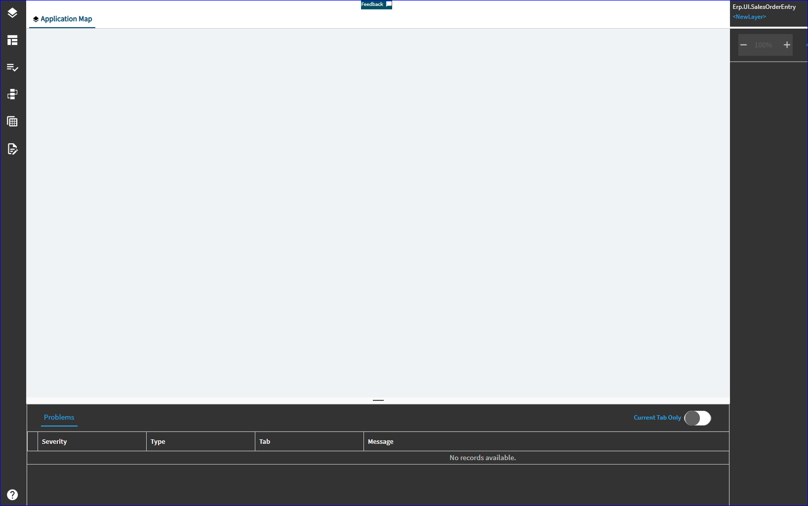

Can’t say its related or not… but I have several forms that even in Kinetic App Studio show up with no Application Maps.
This below example is BASE layer, opened directly from App Studio. Form still works, it loads. But no map. My custom layer also has no map… so I can’t edit it.
PRB0292253

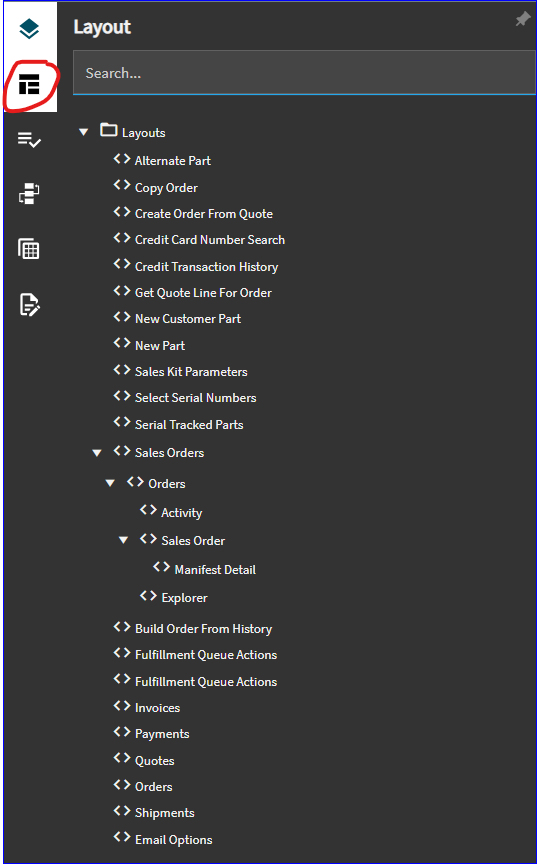

In App Studio, I’ve found you can at least get to SOME pages by opening them via the Layout slideout… so I can actually get to the main Order page. but I can’t get to, for example, Line Details… or Release Details, because they’re not listed in the Layout.

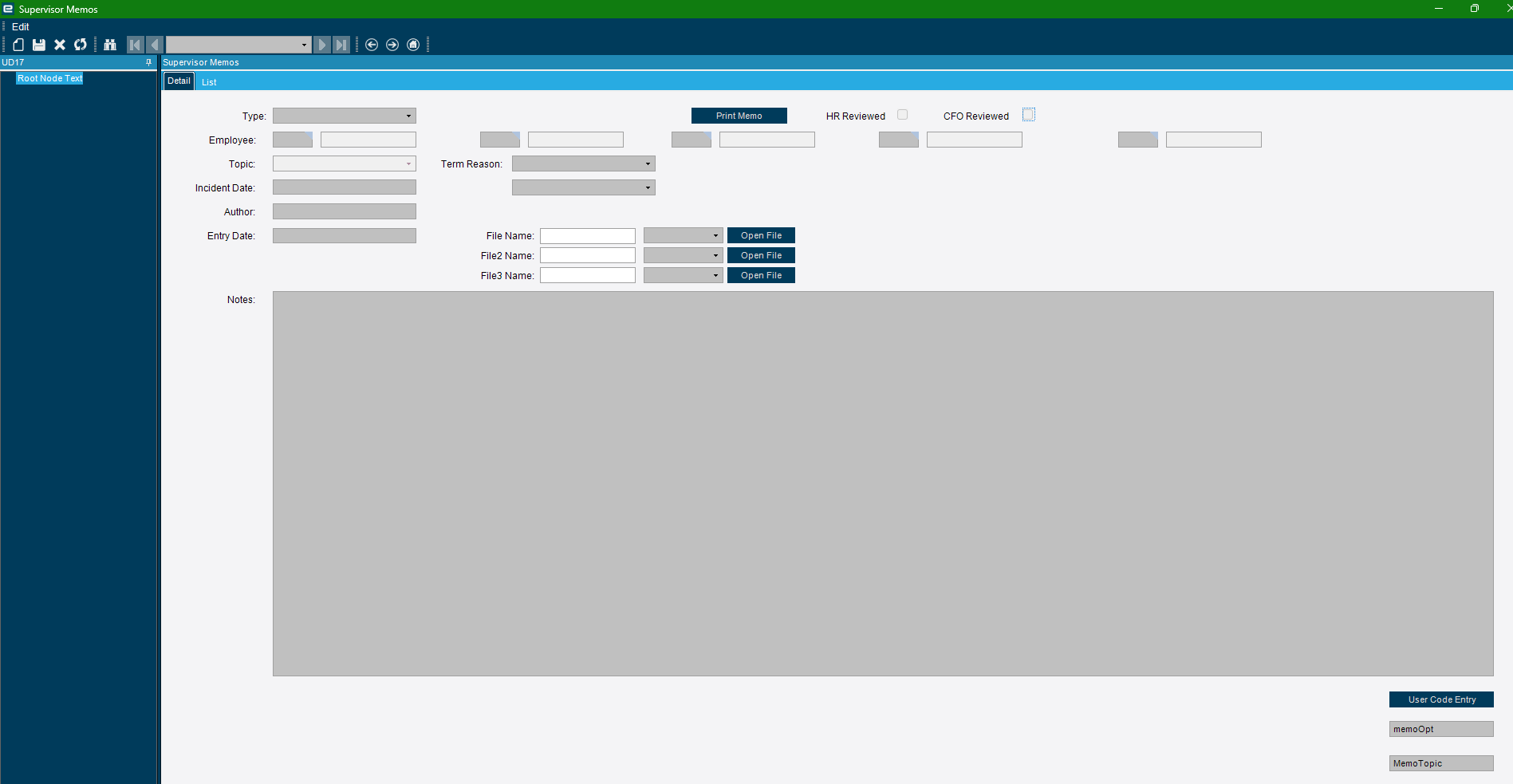

Since the form works in Test, I decided to load it up on Test and just rebuild it control by control in Live and then copy over the code.
And the control locations shuffled on save… (not all of them, just some of them)
Original:

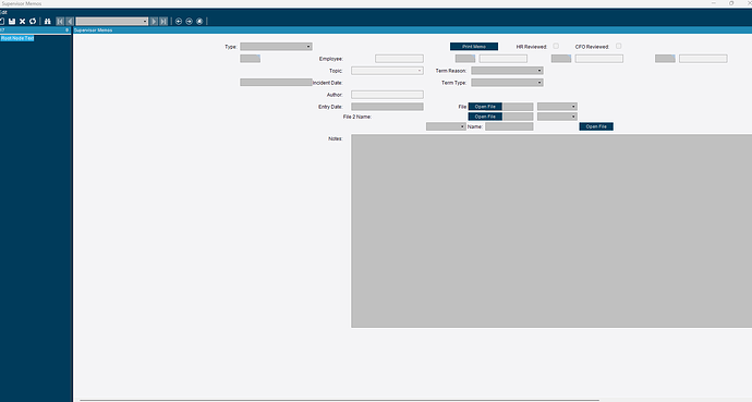

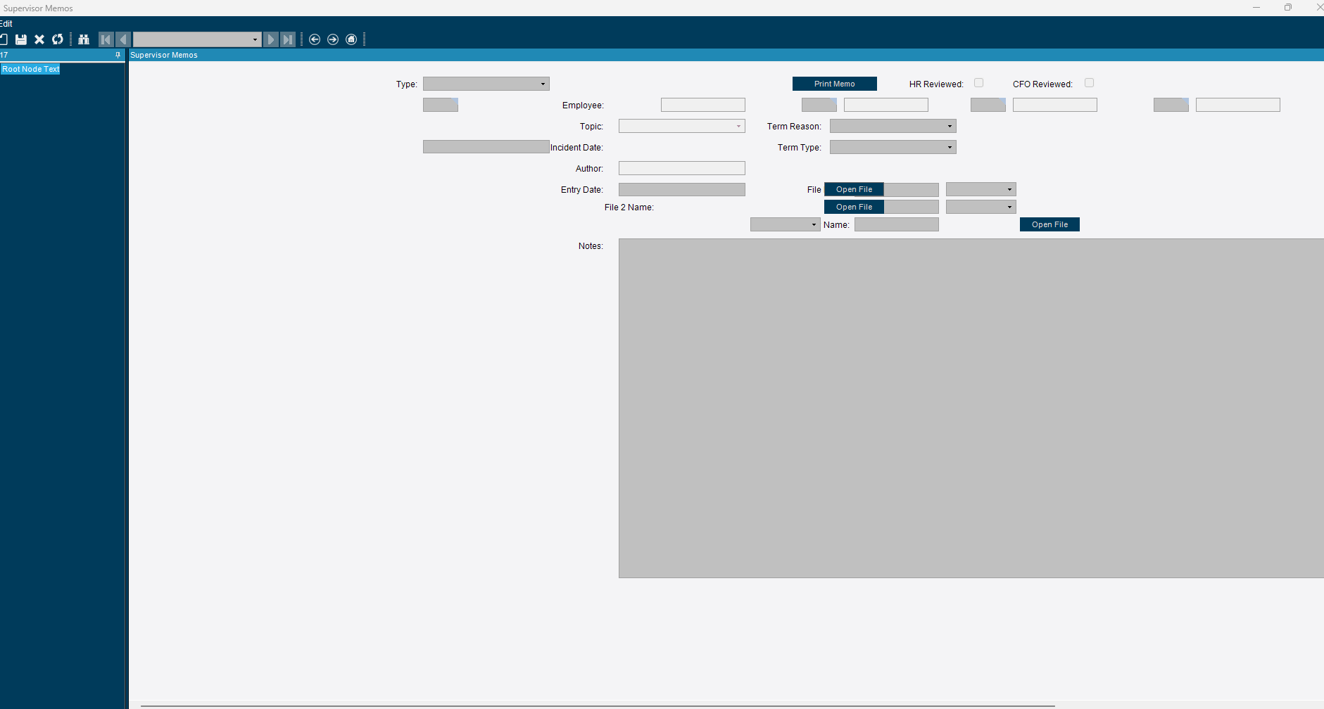

Save and reopen:
And yes, there’s now a scroll bar on the bottom since it shifter everything over a few hundred pixels… Really like to get the first form rebuilt so I can start on the other 8.
