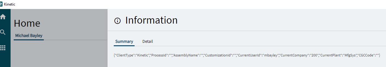

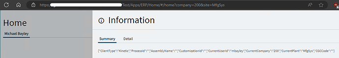

Problem is the call context is the same from both the web browser and the smart client
Browser:
SmartClient:
ClientType=“Kinetic” is the same for both
That’s because they are both the browser. If you run one in classic you’ll see a difference.

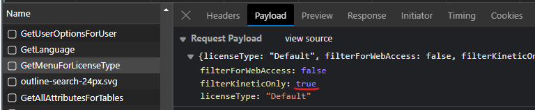

I have done some more digging this morning and discovered that a BPM on MenuSvc.GetMenuForLicenceType will give me what I need.
When Kinetic is started from the browser, there will be a single call to this method. There is a parameter “filterKineticOnly” which will be true

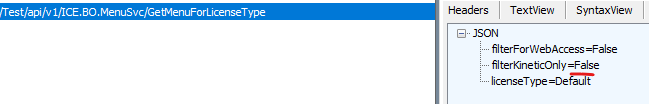

When a Kinetic App is launched from the SmartClient, the embedded browser will call this method also. “filterKineticOnly” will be false in this case. For every embedded browser opened, this method will get called every time.
