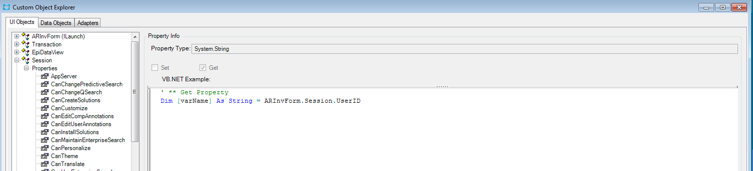

You can use the Object Explorer (shows VB but easily translated into C#) to find this information. You can find the Object Explorer from the Tools menu in the Customization Tools Dialog.
Also good to know, thanks!
