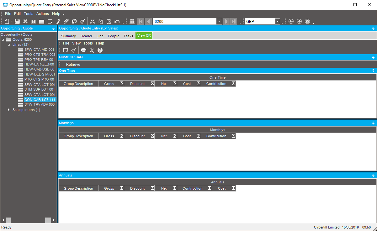

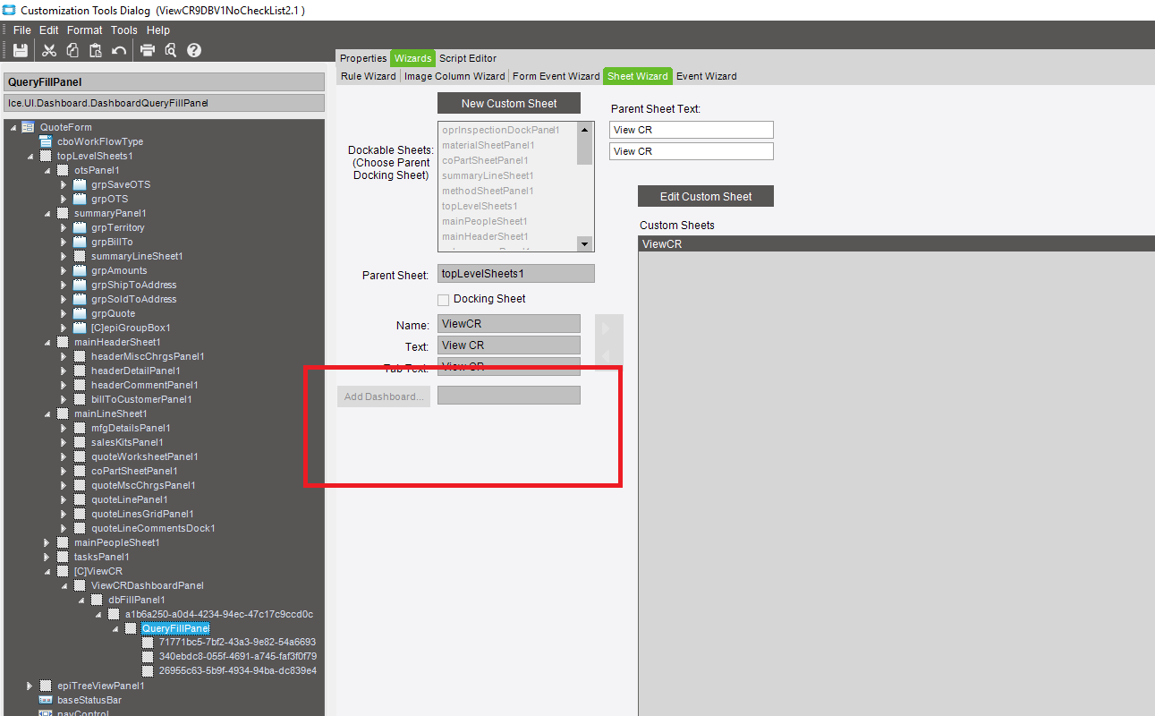

I have a custom sheet added to quote entry.
We added a dashboard to the sheet using the sheet wizard in customisation tools.
At a later date, when you need to debug an issue, how do you know which dashboard it is running?
In the customisation tools dialog, I can’t see any reference to it?
Lets say I used a dashboard named ‘QuoteviewCR2’ and then forgot which dashboard I used - how can I find out? If I try to edit the custom sheet, there is no mention of its ID/name in the wizard menu and nothing from the properties menu.
Any help appreciated!

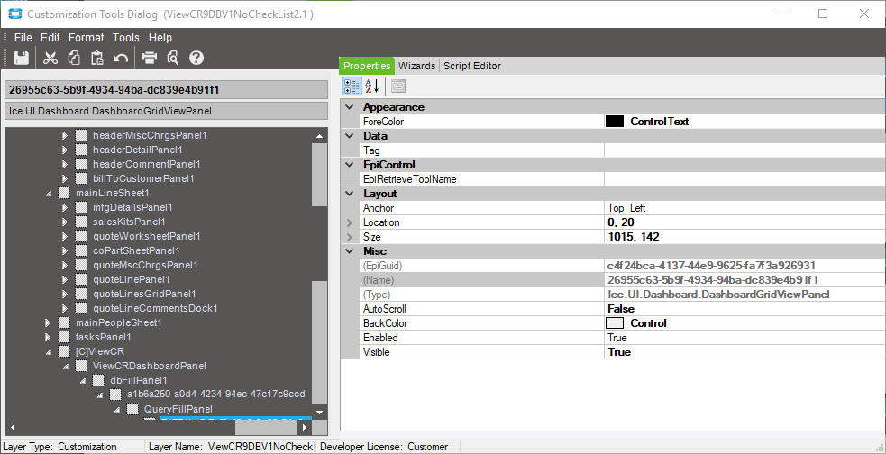

Hello Karen,

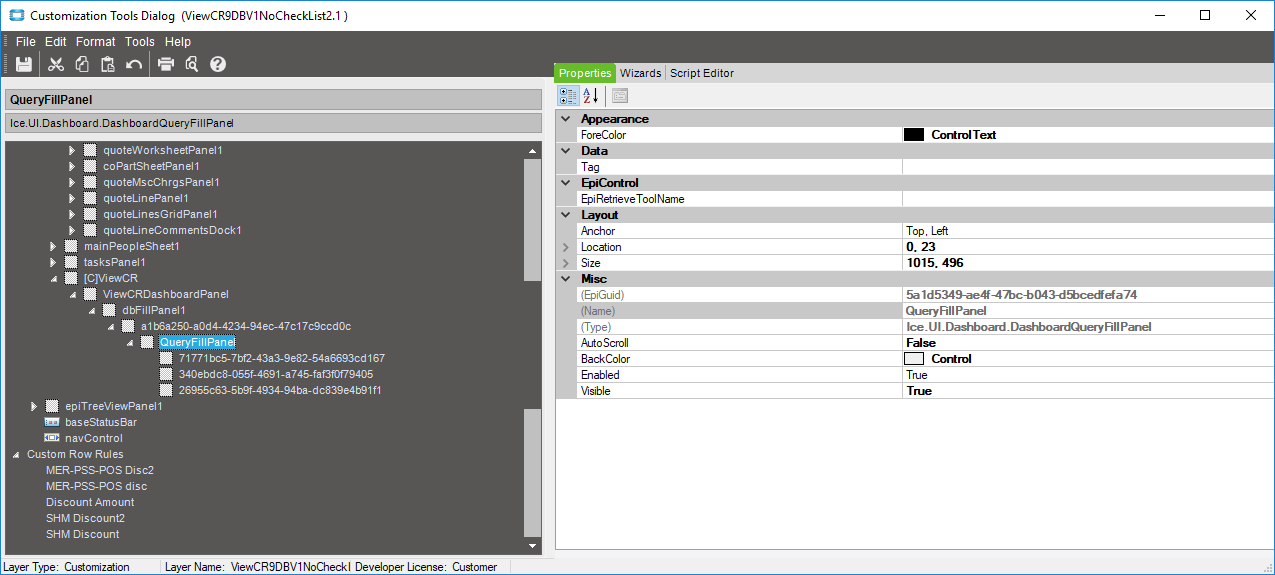

All your customizations are visible via the Custom XML Editor. Look at the Custom controls sheet and in the key column you will see the name followed by it’s ID.
Hope it helps…
Pierre
Thank you!
hadn’t thought of that - can see it now :grinning:
