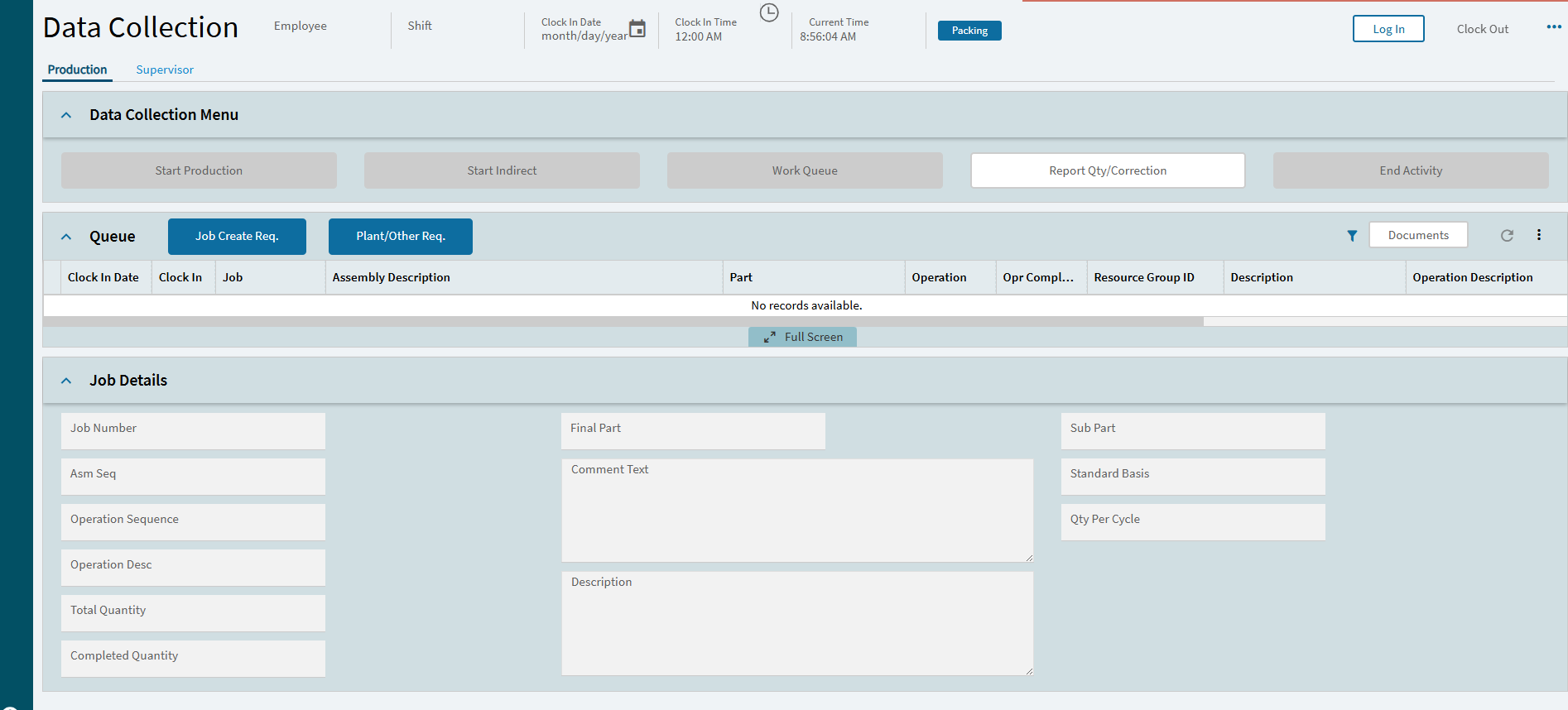

I have a request to turn off the Menu Search(waffle button) while in Data Collection / MES. I have seen posts about turning off Enterprise Search, and EDD, but not about the menu search. I believe the proper way to approach this would be to use menu security to control what shows up in the list, but I was curious if anyone knows of a way to disable it completely?
We just use menu security to basically block them from 99% of the system.
You need to edit the shellRestrictions section of launchmodes.jsonc file. These are all of the options I have found to hide everything.

** NOTE This does not apply to Security Managers. They always see all options.
