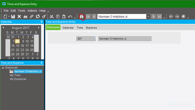

This question might have two different answers, one being a customization and the other being a setting in Time Management I haven’t found.
We just purchased Time Management so that we can approve all time detail records to be compliant with a DCAA audit. Part of the requirement is that Supervisor/approvers can’t delete or adjust the time record. This will require each employee to have access to Time & Expense Entry to make any needed adjustments. However, they can only have access to their time records and not other employee’s records.
In the Time Management settings, you can restrict access for entering/editing time transactions for other employees. However, that does not stop someone from being able to look at others records.
So I thought I would remove the employee search button from the T&E Entry form and make the EmpID fields read-only; however, there is still the search button in the tool bar that allows you to search…
Is there a setting I’m missing? Or is there a way through Screen customizations to disable the search button in the tool bar?
I think you should be able to use Form Event Wizard and beforeToolClick and handle that button. I don’t know off the top of my head how to determine what tool clicked but once you find out:
private void TimeExpenseForm_BeforeToolClick(object sender, Ice.Lib.Framework.BeforeToolClickEventArgs args)
		//code to determine sender here....
              if(SearchClicked)		args.Handled = true;
Try something like this.
baseToolbarsManager.Tools["PrimarySearchTool"].SharedProps.Visible=false;
You will need to add a using statement (using Infragistics.Win.UltraWinToolbars;). I have used this to disable delete, etc. but not this exact toolbar item.
Thanks @danbedwards, thanks worked.
