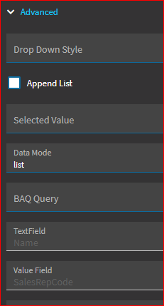

Make sure you have values entered in TextField and ValueField under Advanced properties.
For ex.
Thank you, That was what I was missing.
