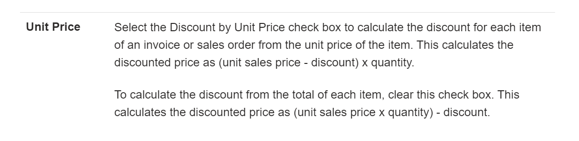

Create a new price list and include ‘TestDisc’ part and give it a base price of £1213.88
Assign the price list to a test customer with a 40% discount
Create a sales order for the test customer with a discount of 40%
Create an order line for 20 * ‘TestDisc’
If the discount price were rounded, then the new unit price would be £728.21 and the line amount would be £ 14,564.20.
I tried ‘Round discount by unit price’ and got £14,564.16
I tried 'Round discount by extended amount and got £14,564.16
What I need is the unit price to be discounted by 40% and then rounded, so in this case the discounted unit price is 1213.68*0.6 = £728, 21 to 2dp and the overall discount is £9709.40.
If you have time, would you be able to test the above scenario in your test environment, as I would love to know how the above scenario works on 10.2.6, as this was tested on 10.2.5.
