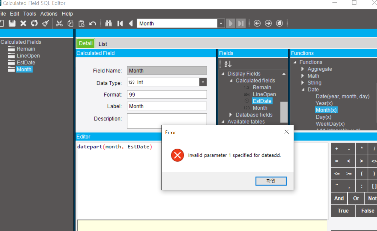

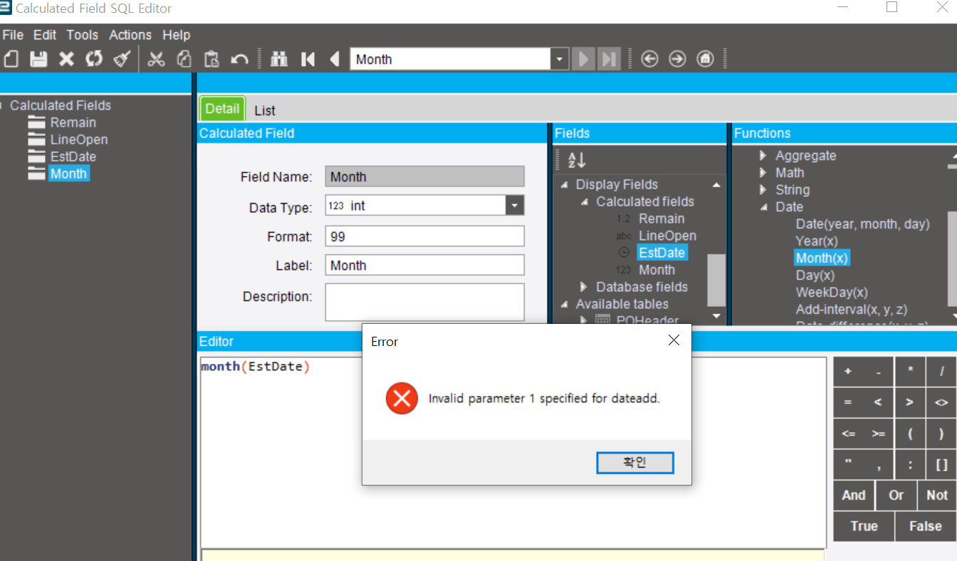

Hello everyone,
I would like to convert date representation to month representation in BAQ.
ex) 2023.10.23 >> 10 2023.09.18 >> 9
I used the Month function, but I got the error popup below.
What could be the problem?
Thanks in advance!

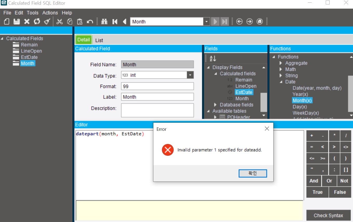

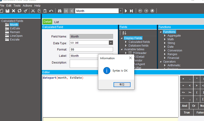

Hi,
Datepart should work, Try changing date to Datetime.else try with month(Date)
Thanks,
Arun

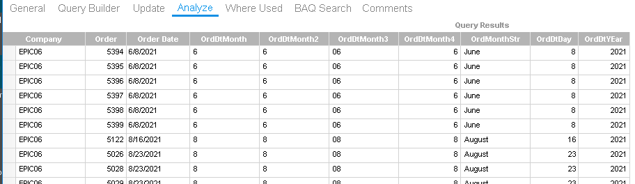

Hi, here some samples using DATEPART.
select
	[OrderHed].[Company] as [OrderHed_Company],
	[OrderHed].[OrderNum] as [OrderHed_OrderNum],
	[OrderHed].[OrderDate] as [OrderHed_OrderDate],
	(CAST(DATEPART(MM, OrderHed.OrderDate) AS CHAR(2))) as [Calculated_OrdDtMonth],
	(datepart(month, OrderHed.OrderDate)) as [Calculated_OrdDtMonth2],
	(CASE WHEN DATEPART(MM, OrderHed.OrderDate) > 9 THEN  CAST(DATEPART(MM, OrderHed.OrderDate) AS CHAR(2)) ELSE '0' + CAST(DATEPART(MM, OrderHed.OrderDate) AS CHAR(2)) END) as [Calculated_OrdDtMonth3],
	(DATEPART(MM, OrderHed.OrderDate)) as [Calculated_OrdDtMonth4],
	(CASE DATEPART(MM, OrderHed.OrderDate)
 WHEN 1 THEN 'January'
 WHEN 2 THEN 'February'
 WHEN 3 THEN 'March'
 WHEN 4 THEN 'April'
 WHEN 5 THEN 'May'
 WHEN 6 THEN 'June'
 WHEN 7 THEN 'July'
 WHEN 8 THEN 'August'
 WHEN 9 THEN 'September'
 WHEN 10 THEN 'October'
 WHEN 11 THEN 'November'
 WHEN 12 THEN 'December'
 ELSE ''
 END) as [Calculated_OrdMonthStr],
	(DATEPART(DD, OrderHed.OrderDate)) as [Calculated_OrdDtDay],
	(DATEPART(YYYY, OrderHed.OrderDate)) as [Calculated_OrdDtYEar]
from Erp.OrderHed as OrderHed
I tried that, but I got the same result.

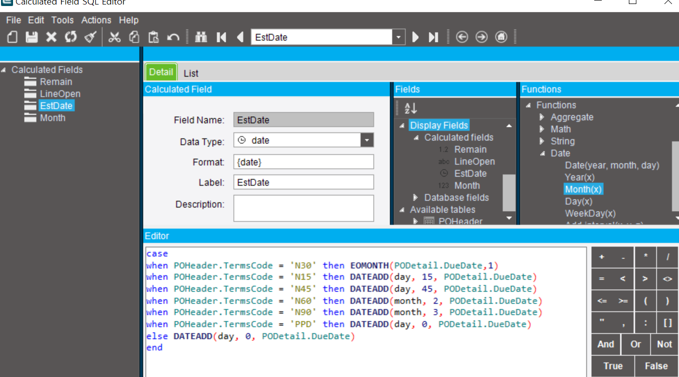

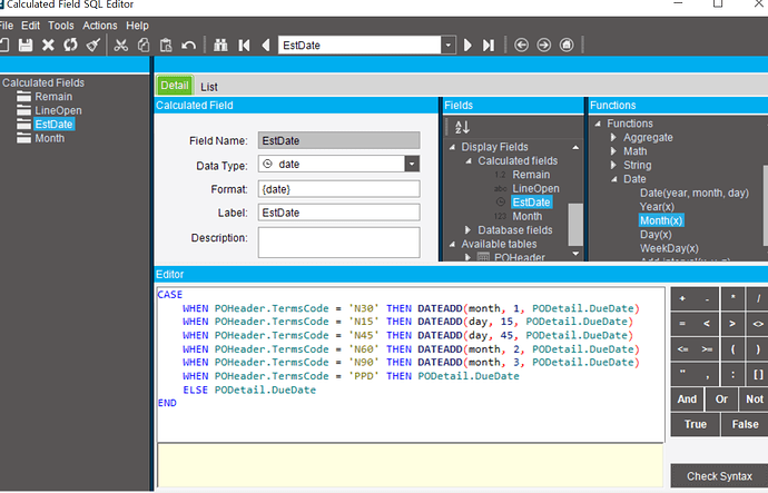

Does any of the other calculated fields use dateadd?
CASE
    WHEN POHeader.TermsCode = 'N30' THEN DATEADD(month, 1, PODetail.DueDate)
    WHEN POHeader.TermsCode = 'N15' THEN DATEADD(day, 15, PODetail.DueDate)
    WHEN POHeader.TermsCode = 'N45' THEN DATEADD(day, 45, PODetail.DueDate)
    WHEN POHeader.TermsCode = 'N60' THEN DATEADD(month, 2, PODetail.DueDate)
    WHEN POHeader.TermsCode = 'N90' THEN DATEADD(month, 3, PODetail.DueDate)
    WHEN POHeader.TermsCode = 'PPD' THEN PODetail.DueDate  -- No change
    ELSE PODetail.DueDate  -- Default to no change
END

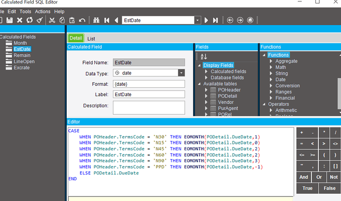

Yes. I used Dateadd on EstDate. (as you can see in the screenshot above).
Try above.
I tried what you suggested, but the same problem still occurs.
I just got rid of all DATEADD. I had no choice but to use EOMONTH (although the exact date will not appear).
But now MONTH appears well. I think maybe DATEADD and datepart don’t work together.
Thank you to everyone who helped.
To do something this I added a join to Purchase Terms and just use the actual due days.
dateadd(day, PurTerms.NumberOfDays, PORel.DueDate )
