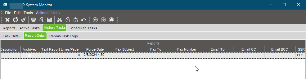

It’s in the classic System Monitor though the BAQ ideas above are probably better
