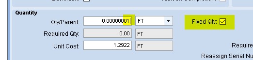

We are trying to put zero quantity materials at the top of the Job Pick List, because wires need to be cut to a certain specification, which is on the BOM with quantity of zero.
When I run a BAQ with JobMtl, it shows all items including zero quantity ones. But the JobPickL RDD doesn’t seem to let any zero quantity records get to the report. I haven’t found a filter or visibility anywhere in the report that might be controlling this.
Does anyone have an idea of how I might get these materials onto the report?
Thank you Calvin…after a lot of banging my head on the keyboard I came to similar conclusions.
I’m not sure of how to bypass the RDD and query the JobMtl table directly. I might just add PartMtl to the RDD and just tell engineering/kitting that this will break down if they don’t have matching specifications on job and part, which should be rare.
