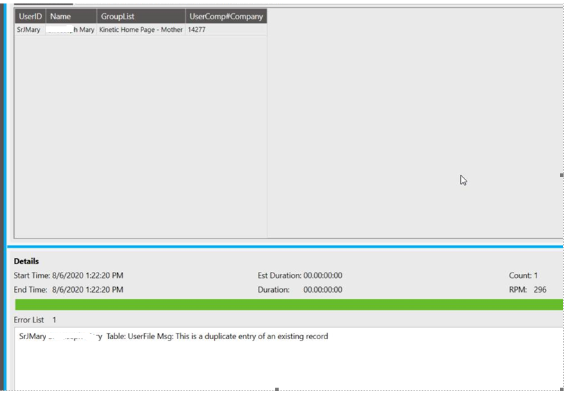

Hello!
Does someone know the best to add a additional security group to a user in DMT?
Since the user already exists with 1 existing role, the DMT tool thinks its a duplicate.Trying to add more than 1. Thanks!!
