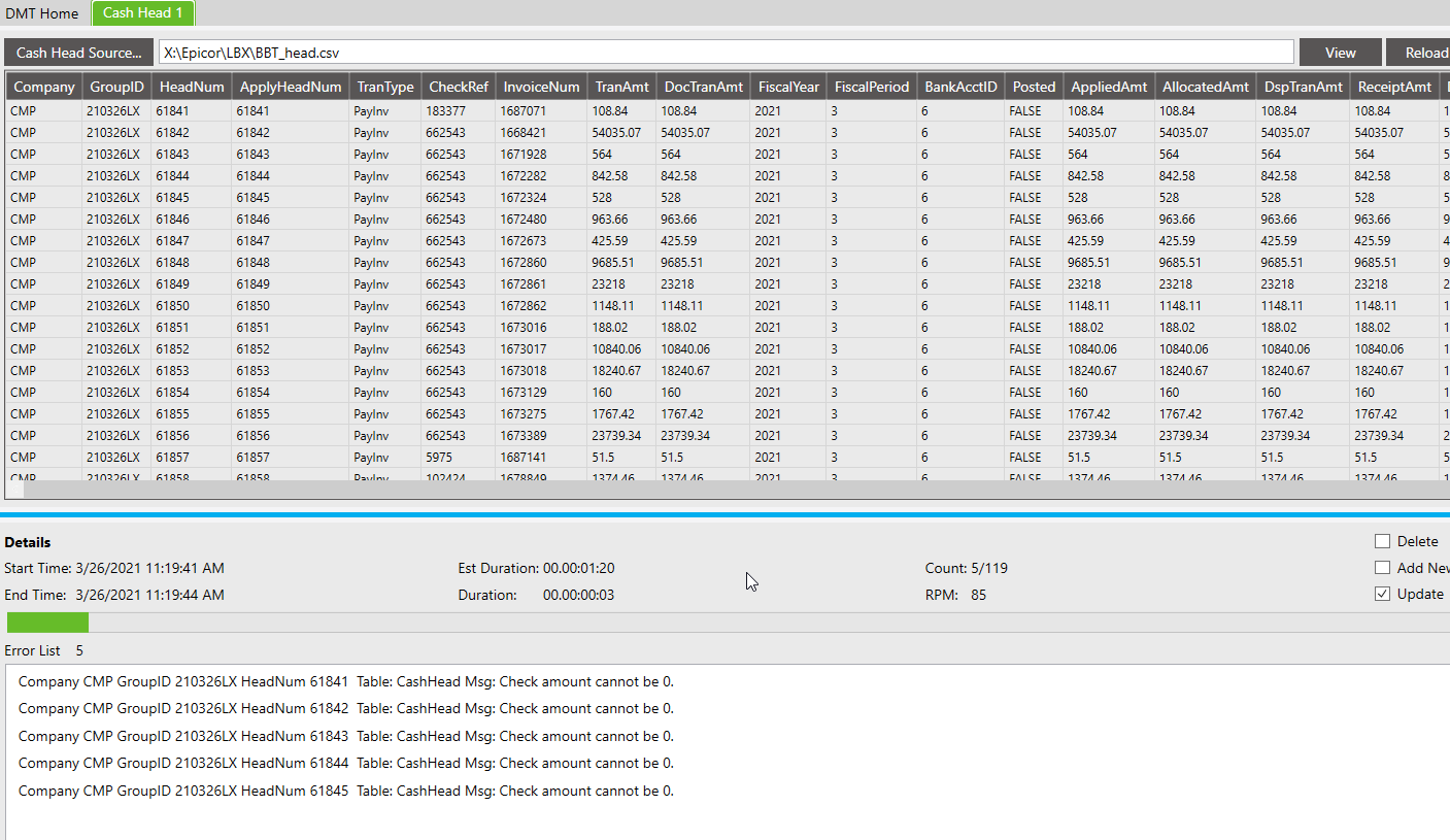

when i try to load a DMT for cashhead i get the error in the picture below i went to template because i thuoght i missed a field and there is no field related to check amount so i look for a description of the field that said something about check description and i found that DspTranAmt is the amount for check i added to my DMT csv and i still get the error
That’s odd because this error happens when DocTranAmt is 0, and based on your screenshot it is populated.

I learned a couple of things playing with DMT, the column order is very important and the required column list is only the bare minimum.
Add column ReceiptCurrencyCode before any amount, so that amounts are correctly entered.
i found the issue i need to use the template cash combined
