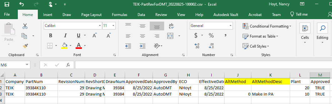

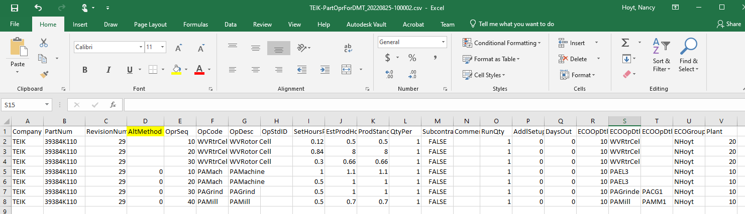

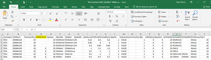

Paul’s idea to only add new seems good. Also here is a copy of one of our Alt method DMT edits. It might be useful. It’s both the PartRev w Alt Method and regular method and PartOpr w Alt Method and regular method.
