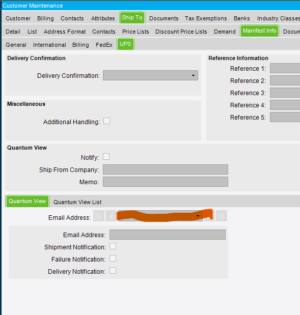

I am trying to import some UPS Emails to my customers shipto but it keeps telling me I need the column UPSSQVSeq. What is this? It is not anywhere I can find in a BAQ or a field in Customer Maint.
I think it is this.
Just tried putting an email in for that and it says the column is not valid.
I believe it is a sequence field. I would try a 1 or a 10
Tried the one, and just tried the 10, same problem…Not valid. Ugg.

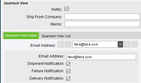

I manually added one. You need to have the Notify box checked before you can add an email.
