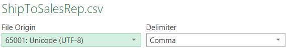

Solved my own issue.
In Excel, one must Data → Get Data ‘From Text/CSV’
‘Load’ in order to have Excel respect the French characters. Then and only then ( using the Excel file ) will DMT maintain the ascii characters.

Ok - found a way around disappearing leading zero’s on import. Still a pita, but does solve the problem.
When on the first screen ‘From Text/CSV’, select ‘Transform Data’ instead of ‘Load’
Next screen - ‘Advanced Editor’
Where it says ‘Int64.Type’, change to ‘type text’ — And walla, respect for leading zeros!
