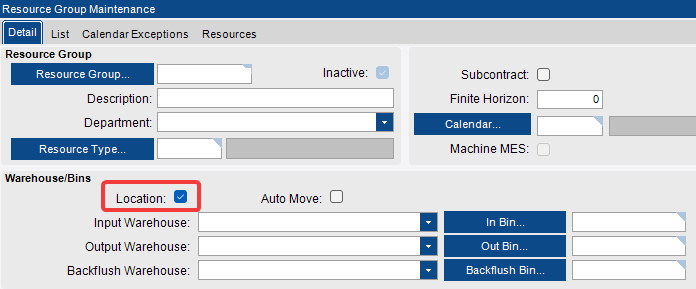

The Resource Group/Resource being reported on the Labor Detail needs to be set as a ‘Location’ in Resource Group maintenance.
Will check this out , very much appreciated.
