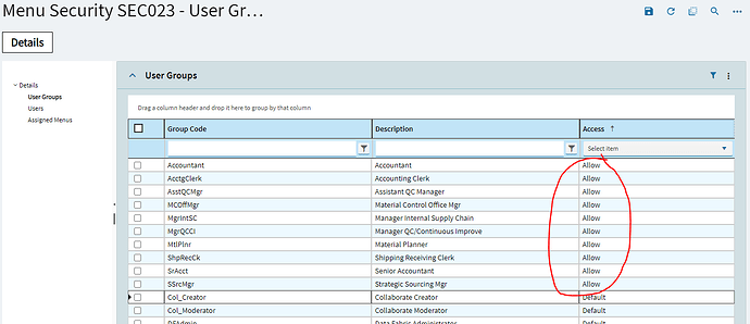

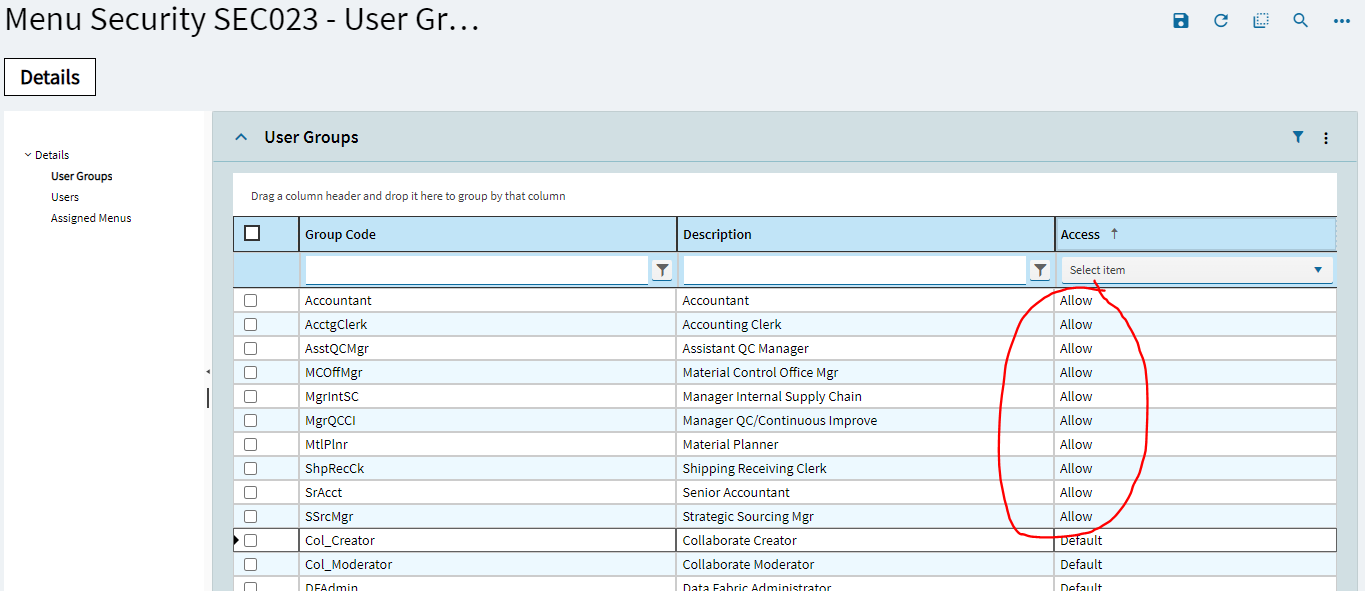

Regarding the Kinetic Menu Security. I am on 2023.1.10 and there is a column for “Access” which shows Allow for the Groups that are assigned to the menu.
