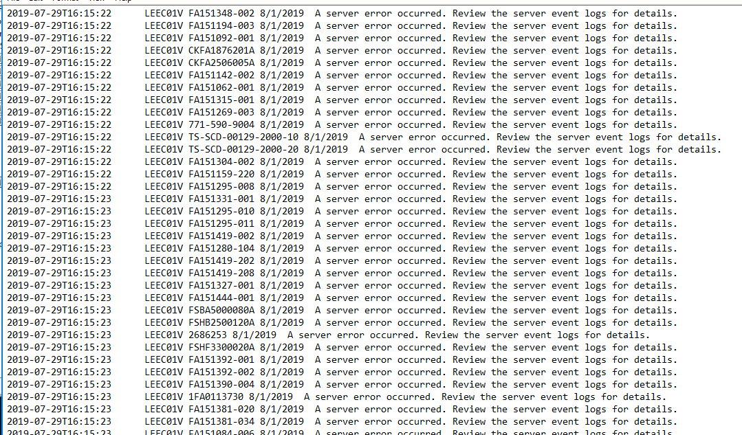

I restored my Training environment and ran a DMT update for Supplier Price List (which I ran successful a week ago). I got the following errors… What server logs are they talking about and where are they?

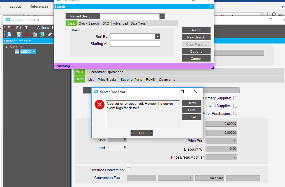

The odd thing too is when the user went to access Supplier Price list they got the following error.
Any thoughts for direction to figure out what is going on? I have no problems restoring Training again if needed.

They are in the event viewer on the application server. Under Applications and Services is Epicor App Server. It is the new location of the Progress Server logs.
