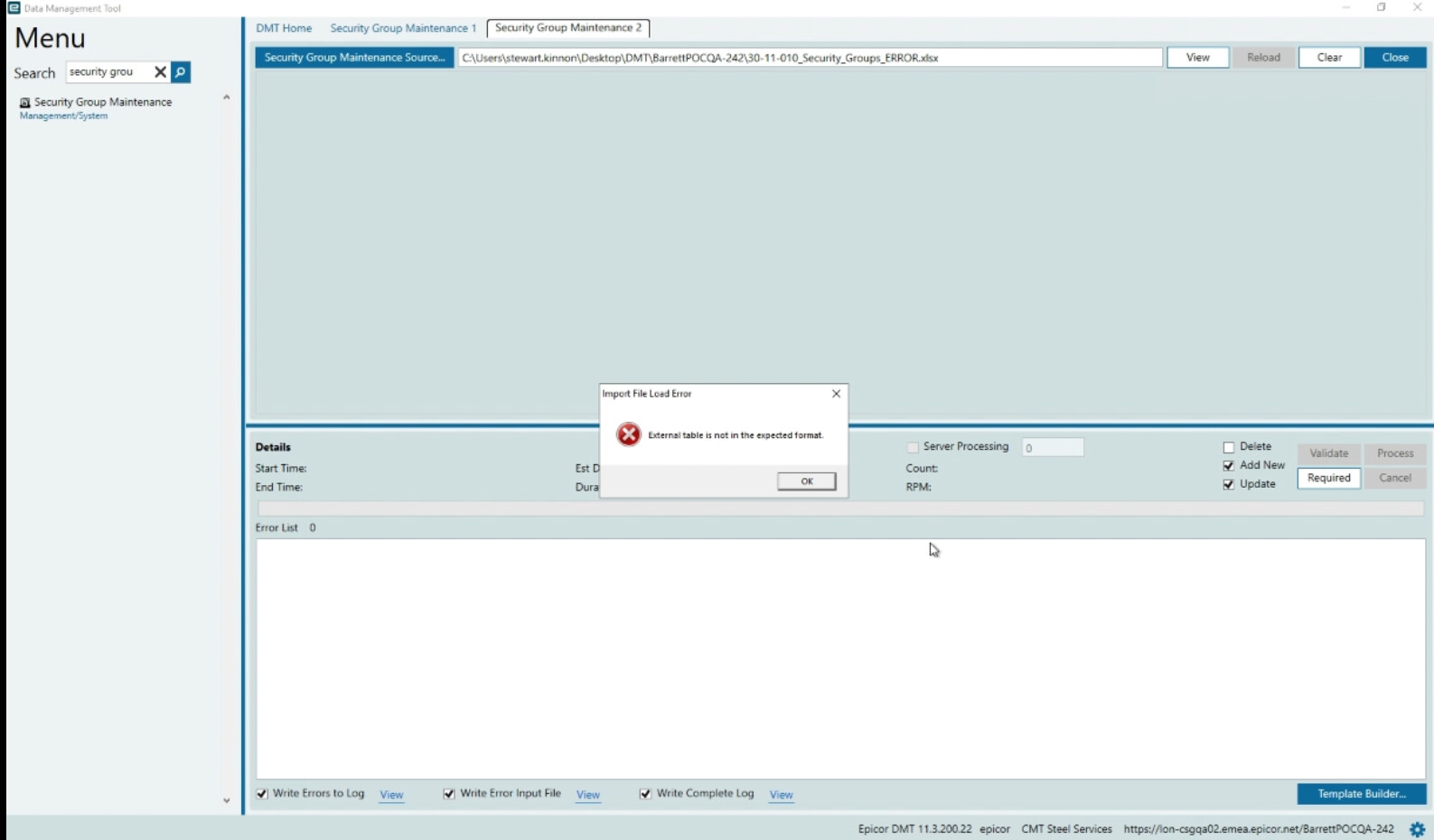

I’m trying to gauge how much of an issue this is generally. I work with DMT a lot, I can run a file, then try to run exactly the same one again but get an error message saying, “DMT - External table is not in the expected format”. Workaround is to copy and paste the contents into a different xlsx file, very frustrating.
Does anyone else experience this? If so, how regularly?
